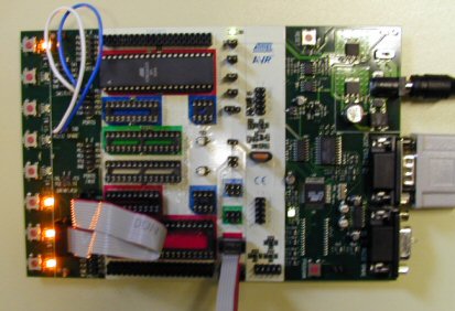

The AVR IAR demo application is configured to run on an Atmel STK500external_link prototyping board using an AVR ATMega323 embedded processor running at 8MHz (instructions are provided should you wish to use an alternative development board). If an ATMega32 is used the frequency can be increased to 16MHz. The port is also being used with ATMega128 processors.
The 2KBytes of RAM on the ATMega323 is enough to run 10 real time tasks - including the idle task.

Demo application hardware setup
The following links must be in place on the STK500 prototyping board for the demo application to operate - these can be seen on the photograph above:
  1. PORTB to LEDS
  2. PORTD bits 0 and 1 to RS
  3. SPROG3 to ISP6PIN (correct link to program an AVR ATMega323)
The demo application includes tasks that send and receive characters over the serial port. The characters sent by one task need to be received by another - if any character is missed or received out of sequence an error condition is flagged. A loopback connector is required on the serial port for this mechanism to operate (simply connect pins 2 and 3 together on the serial port connector).

The RTOS demo application creates 10 of the standard demo tasks.
  1. LEDs 0 to 2 are under control of the standard 'flash' co-routines and flash at a regular rate. Each LED is flashed by a separate task.
  2. LEDs 4 and 5 are under control of the standard 'comtest' tasks. LED 4 toggles every time an RS232 character is transmitted. LED 5 toggles every time an RS232 character is received and verified.
  3. Not all the tasks update an LED so have no visible indication that they are operating correctly. Therefore a 'Check' task is created whose job it is to ensure that no errors have been detected in any of the other tasks.
LED 7 is under control of the 'check' task. LED 7 will flash every few seconds provided no errors have been detected in any of the other real time tasks. If an error is detected in any other task then LED 7 will stop flashing.
