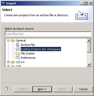

  3. Select "Import..." from the Freedom Studio 'File' menu. The Import dialog box will open.
  4. In the Import dialog box, select "General->Existing Project into Workspace". The Import Projects dialog box will open.

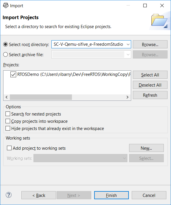

Importing an existing project into the workspace 5. In the Import Projects dialog box, navigate to and select the FreeRTOS/Demo/RISC-V-Qemu-siFive_e-FreedomStudio directory, and ensure the 'copy projects into workspace' check box is not checked.
Selecting the directory and project in the Import Project dialog box. Click to enlarge. 6. In the 'Projects' window of the Import Projects dialog box, select the RTOSDemo project, and click finish. 7. Select "Build all" from the Freedom Studio 'Project' menu. The project should build without any errors or warnings, and create a file called RTOSDemo.elf.

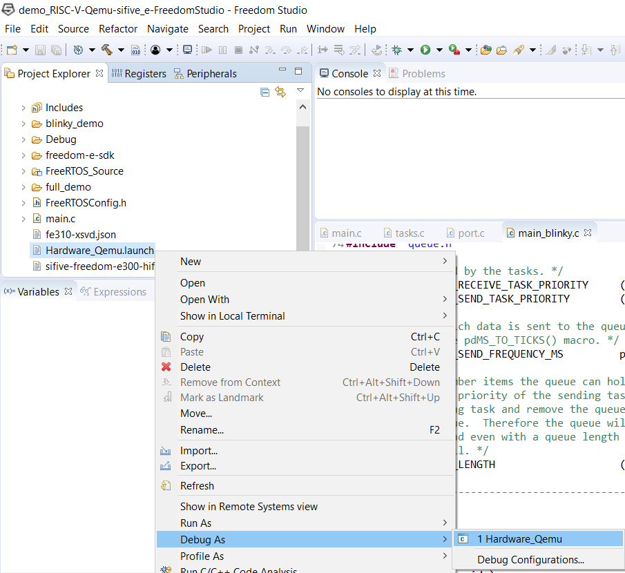

  1. Finally, right click the "Hardware_QEMU.launch" file in the Eclipse project explorer, then select "Debug As->Hardware_QEMU" from the pop up menu. The debugger should start and connect to QEMU (assuming the previous step left QEMU running).
Creating a debug launch configuration. Click to enlarge.
