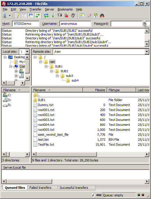

The FTP server can be accessed using a standard FTP client, such as FileZillaexternal_link. To connect:
  • Enter the IP address or hostname of the FTP server as the host (the FTP server is the target running FreeRTOS-Plus-TCP).
  • Enter "anonymous" as the username.
  • Leave the password blank.
Viewing the example files on the RAM disk in the FileZilla FTP client
