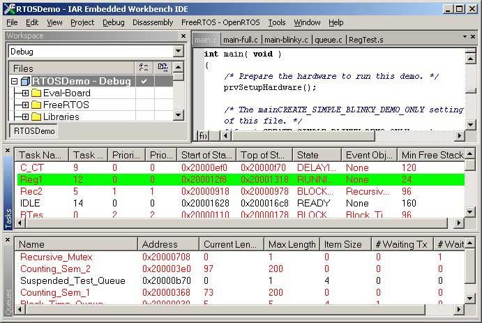

FreeRTOS kernel aware debugger used with the IAR compiler
Screen shot of the FreeRTOS state viewer plug-in
that ships with the IAR IDE

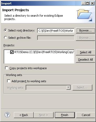

  3. Select "Import" from the IDE's "File" menu. The dialogue box shown below will appear. Select "General->Existing Project into Workspace", as shown below.
Importing the ARM Cortex-M4 RTOS demo project into the DAVE Eclipse IDE
The dialogue box that appears when "Import" is first clicked 4. In the next dialogue box, select FreeRTOS/Demo/CORTEX_M4F_Infineon_XMC4000_GCC_Dave as the root directory. Make sure the RTOSDemo project is checked in the "Projects" area, and that the Copy Projects Into Workspace box is not checked, before clicking the Finish button (see the image below for the correct check box states).
Selecting the RTOS source code when importing into Eclipse CDT
Make sure RTOSDemo is checked, and "Copy projects into workspace" is not checked 5. After the project has been imported, right click on the project name in the DAVE Eclipse project explorer window, then on the pop-up menu select "Build Configurations->Set Active" to set the build configuration to the correct option for your target hardware. Build configurations are provided for the XMC4200, XMC4400 and XMC4500 Hexagon Application kits. 6. Select "Rebuild Project" from the DAVE Eclipse "Project" menu to build the demo project. 7. Select "Debug" from the Eclipse "Run" menu to configure a launch configuration that can be used to program the microcontroller flash memory and start a debug session.

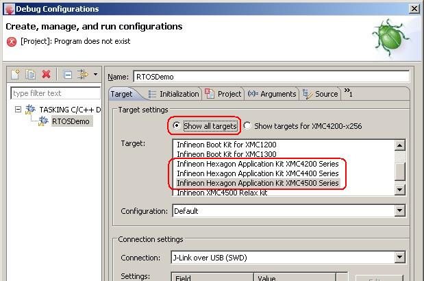

Note: At the time of writing each build configuration within a DAVE project must target the exact same microcontroller part number. The delivered build configurations are however configured to selectively include and exclude chip specific files, so the projects will be built correctly, although an additional step is required when starting a debug session; Check the Debug launch configuration to ensure it is configured to target the hardware actually being used (see image below). It is likely that the debugger will also issue a warning when a debug session is launched - the warning can be ignored providing the launch configuration is configured correctly for the hardware in use.
Selecting the ARM core in DAVE
Selecting the target in the debug launch configuration
